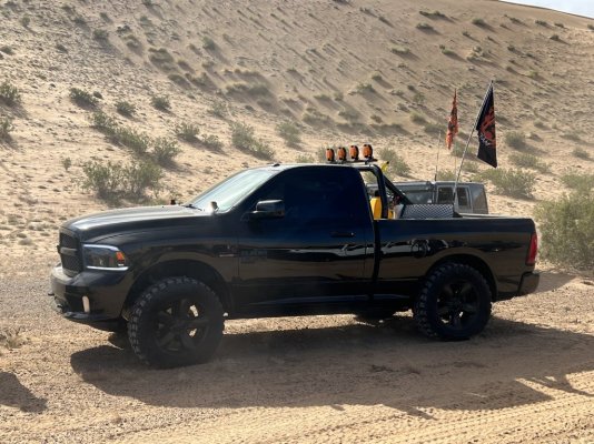

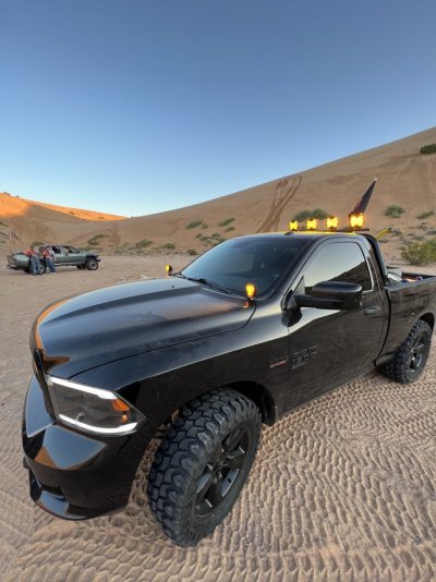

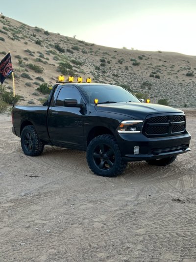

Hello! My first interaction here, I have the same wheel and went for the 295/65R20 gladiator x comp, so far they feel great, lil noisy but normal nothing unbearable, I already took em to the desert, here's a few shots.

Width of your new tire is only 11.6", so 1.8" wider on each side than the rim. That is well within tolerances.

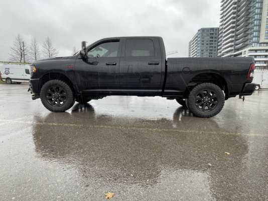

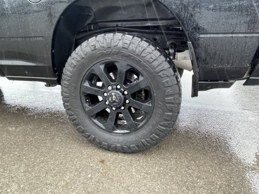

I recently put on nitto grapplers 295 65 20 on stick 20” rims… it rubs on the sway bar and the frame… will 2.5 level( putting it in soon) and or spacers 2” solve the issue?
A level wont help at all, but the wheel spacers will cure the rubbing. However, rubbing there really dosnt cause any issues.

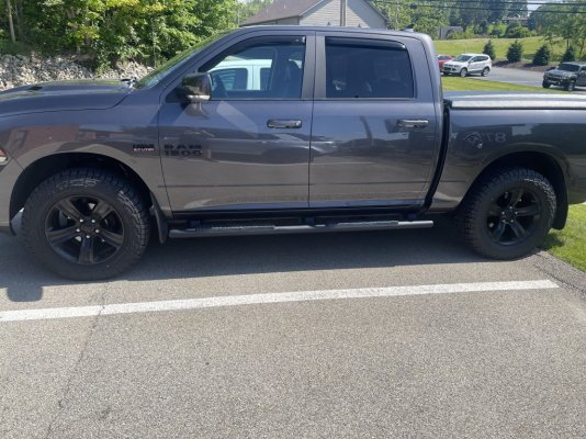

I wanted to throw my input out there with my 2017 sport night edition. Stock rims, 285/65/r20 wildpeak AT4W on Bilstein 5100 leveling kit (set a 2 inch). Very happy with the look, and zero rubbing issues even a full turn.
