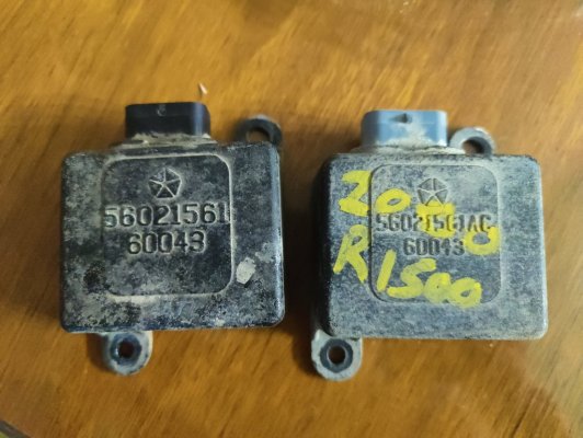

Wanting to know if these drl modules are interchangable
Takenhyperion
Jul 13, 2020
10
23
Fort Smith nt
1998
V10
IMG_20210901_192845.jpgwas wondering if these drl modules are interchangable I have a 1998 2500 dodge ram

After looking at a 1998 and 2001 service manual it appears that the plugs are the same but they are wired differently. I know that my 1999 favors the 2001 manual when it comes to wiring.
