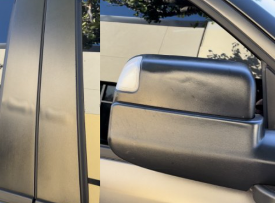

New to forum but urgently need help; During my 3yr lease on a 2019 Ram 1500 Bighorn the plastic window pillars AND casing of side view mirror warped 2-3 times during that period, then traded vehicle in for a 2021 (same type vehicle) and just happened again towards end of summer. Dealer Service Dept continues to state 1) NEVER heard of this problem, 2) I must be contributing towards problem, 3) Will no longer do repair/replacement for free meaning cost on me. This is a huge issue to me considering if happens again (which assume yes), that I will be riding around with a crummy look on truck and at end of lease Chrysler will back charge me. So in short, has ANYONE experienced this under normal environmental conditions (live in CT and park on pavement in front garage) and what recourse do I have against Dealership and/or Chrysler.....help as I am totally frustrated with truck, mfgr, dealership, and how service-sales-chrysler act as independent parties!

Warping occurs on side facing east exposure of sun but we live in CT as opposed to extreme heat states, the townhouses that surround the parking area are beige vinyl siding, pavement is asphalt, none of this seems drastic meaning normal environment. I can’t think of anything else….thoughts?

Like above, it is often a man-made phenomena that impacts us in ways not actually seen. With my uneducated guess that it is some type of focused energy bring your problem this is going to take some investigation on your part. Perhaps the houses are in a circle and the windows of different houses all reflect energy back to a specific set of points throughout the day. Or other vehicles nearby do the same thing. Below is an article that talks more about the issue. Not sure what you can do to fix things, best idea I have is close a white sheet in doors draped over outside to reflect energy back. Remember, it isn't the heat so much but the energy that gets focused and results in cooking your panels.

Holy Cow....yes, same issue....very disappointing as I don't have too many options as cant use garage (that's for my Sweetie), cant use townhouse parking (that's for Visitors), pain to drape sides with sheet (rain and wind), and there are 2 other trucks in townhouse development that park same (no issues)...I understand focused energy as an engineer but still very surprised there are NOT a ton of other complaints on this issue and how the dealer service and sales respond that never heard of this problem
below is pic of the ram-trx person's truck which are same as mine but terminology NOT melting...really warping 1674760169794.png

Sounds like same problem, but misunderstanding that it is not the temperature around the plastic but the conversion of the solar energy to thermal energy at the focal point. Think of an attic in the summer: the air temperature may be 90 degrees, but the roof heats up to 140 degrees due to absorbed energy from direct sunlight. This surface temperature would then be significantly higher if you then add a object that constantly reflects sunlight onto that surface as well. That is when the plastic melting point is breached.
I can't say what today's plastics on cars are designed to withstand but it has to be pretty high. However, exploring the circumstances of each plastic failure should find either a defect in the entire batch, or if not then it is arguably the individual owner's unexpected environment (meaning natural and man-made parts combined) causing the failure.

On my 4th gen the rear bed rails (plastic caps that run the length of the beds on the sides) have melted and distorted due to summer heat and sun here in CT. You can see every anchor point as they all look like divots. What I would recommend is getting some mirror covers and paint matching them or doing whatever you want with them. I used those to cover my chrome stockers and I paint matched them. They look great and you could never tell they are covers. The plastic is thick and uses 3M tape which I added some but if you have a light color truck you could paint match and that would help. Plus the dealer would never see the warped underside. I bought them years ago but memory says $60 or so for the pair. Just have to match up the year and type of mirror you have.
