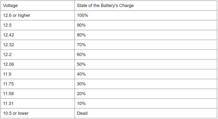

I put a portable jumper on it and it starts. The battery's not all the way dead or the doors wouldn't unlock, etc. and then again I throw the jumper on and it starts right up and runs fine (although the bed lights light is on until I shut it off).
Thanks!
The battery doesn't need to be all the way dead to cause you problems. If it starts with a jump, check the battery.

I replaced the battery, obviously you were right and that was a coincidence, so that's solved. I took it out, ran over to local auto parts store and put the replacement in easy peasy.
