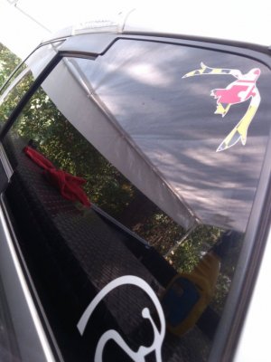

clay bar worked out good
clay bar worked great for removing the thick water spots on my back window thanks for the help guys
