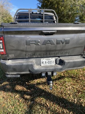

Yea, the WDH was matched with the TT when we purchased it. At that time I was using a 1500. I have just never been a huge fan of adapters, and less so when there are 3-4 tons behind me. Thanks for the reassurance.
Question: do you think the WDH with the 2 shank is less likely to fail over the 2.5 receiver with the 2” receiver adapter?
The same 2” Weight distribution hitch that you used on your 1500 class 4 hitch.
or do you really just want a 2.5 WDH because the Wagon has the class 5 hitch? I have a 2.5 receiver on my PW not because I’m going to pull 21,000 pounds but because I traded my f-250 in and the hitch fit. Now the adapters for cars to receive a 2” into their 1-1/2 hitch, I see as a problem. But that’s because of leverage (to make that adapter work)
