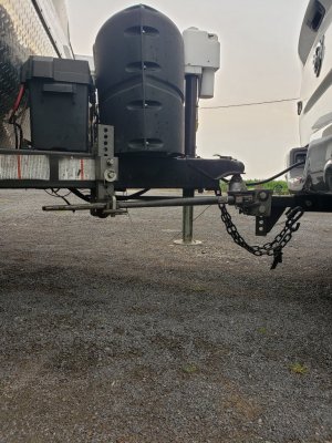

First weigh is the truck, then truck with trailer but no wdh bars and finally truck and trailer with bars.
My gvwr is 6900lbs and looks like I'm over at 7400lbs (steer and drive combined).
I can increase the bar tension by raising it but then it wont be parallel to the frame.
What do you guys think? Also i'm over my gvwr by 520lbs.

I would check the manufacturer of the WDH on the placement of spring bar mounts on the trailer. They look a bit far forward, may have to raise the battery box up to be able to move those mounts further back to get more use of the bars.

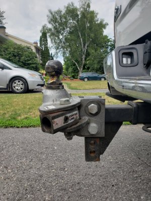

I believe You need to angle the hitch head/ball more towards the rear. I could be wrong, I'm not familiar with that style of wdh. I use the old school chain type weight bars. I dont know how that is done with that particular hitch, you'll need to look at the instructions for it.
When you do that, you should be able to put more tension on the weight bars and transfer more weight back to the steer axle. If your GRAWR is 3900 as 392 states, you must correct that. GRAWR is the most important number not to exceed regularly or your going to hurt rear end components over time (premature failure). As was said prior, at present, your wdh is not transferring much of the weight to the steer axle, i believe due to my above thoughts.

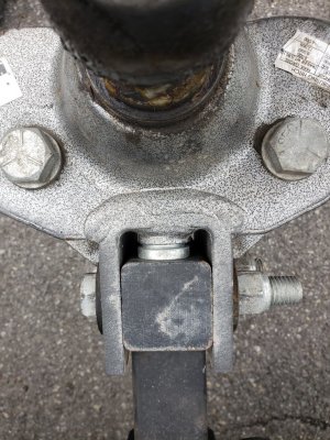

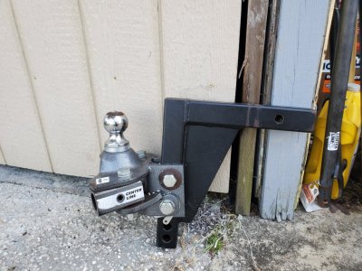

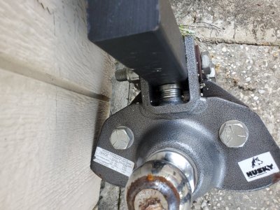

Something doesn't look right. Is the top bolt of the ball mount actually go through the reciever mount? I have a Husky Centerline that I use and have included a couple pictures of the ball angle and where the bars actually make contact with the plates. I believe there are 3 washers on mine that create the downward angle of the ball which gives you more tension on the bars20200720_131728.jpg 20200720_131744.jpg 20200720_132800.jpg

I think you guys are right on the money about the ball head angle. I only have one washer and it doesnt look like there much angle. Going to add 2more washers and go from there. I redistributed the weight in my it's basement and it definitely improved the towing experience and a bit less squat.

Yep, get that head tilted, which will give you more room to pull up the bars. And move the mount on your tongue back.

Yep, good photos. They confirm what I suspected. Get the hitch head tilted more to the rear, more tension on the bars and then weigh it again, fully loaded and see where your at.
