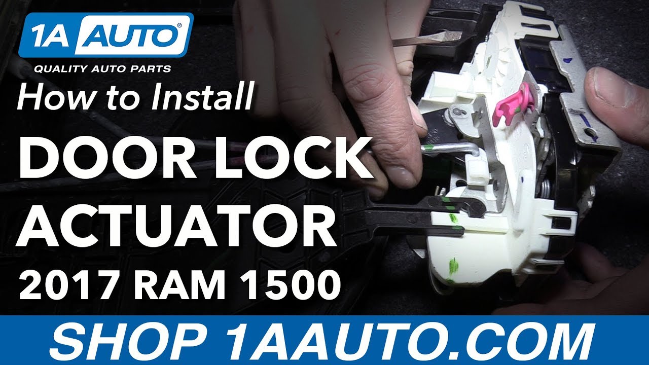

Remove the door cover and look. If the tab is going up and down, the actuator is working. What is likely not working is the bar that attaches to the actuator to actually lock the door. It may have fallen off the tab or the tab may have broken.
For the older trucks since it was there anyhow.
