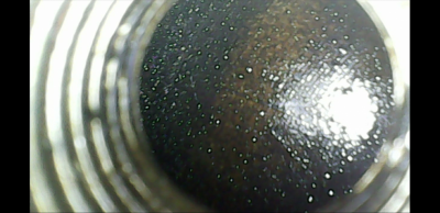

Screenshot_20180211-040518.png Screenshot_20180211-040459.png Screenshot_20180211-040518.png Screenshot_20180211-040459.png I ordered some spark plugs for my 06 1500 5.7. It's a quad cab 4x4. They are coming via prime tomorrow do I decided to get a head start on it tonight. My back isn't that good and plus the drivers side looked like nightmare with the booster in the way. That being said, I jacked up the truck and removed the drivers tire and wheel well which made it alot easier. The spark plugs we not wanting to come out so I read that you should spray them with like pb blaster and let them soak for a minute so I did just that. They were alot easier to come out after. I planned on doing a few other things while I was under there like taking off the valve covers and inspecting for broken or worn springs sticking lifters, etc. Most are known to cause catostropic engine failure (seats and valves dropping into cylinder) so i wanted try and be proactive about it. Also taking off the fuel injectors to give them cleaning. I did a compression check and the ran my borescope into the combustion chamber after.The pistons are now covered in the pb blaster along with carbon build up i and before I put it all back tomorrow, should I be concerned about it being in the combustion chamber? It's a small coating you can say but I took some pics, hopefully i uploaded the correctly. I am also going to attach a piston pic from a few days ago when i first got the camera and wanted to try ot out.

I really don't think the BP Blaster that got in the cylinders should be a problem. There really isn't much you can do about it anyhow, short of removing the heads. It should burn off pretty quickly and be a non-issue.

I would probably hold a rag over the spark plug holes and spin the motor on the starter to pump some of that out before installing new plugs to try to avoid any fouling..
I thought of that, same thing you would do if there was water in the cylinders. It just didn't look like there was enough in there, from the 2 pics, to be of any real concern.
Probably not.. but an ounce of prevention and all....

That pb blaster won’t hurt anything. You might get a tiny amount of smoke from the exhaust for a second after startup, but it’s nothing at all to worry about.

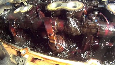

Be happy it doesn't look like this poor, neglected engine!
Lol, yeah I seen the video on YouTube, and ppl were just bashing the hell out of the guy. He was just trying to pass along info. I also forgot to mention, after I tightened the rocker arms, I hooked the battery back up to turn over the motor just make sure everything was doing it's job. It was like 3 in the morning so nobody was around to help me so I rigged up some ground wire around my phone and to my truck by my battery to record it lol. I had to watch it about 8 times in order to watch 2 closely. They looked like they were working good. I am curious and need to look up whay stock springs look like tho. I remember someone saying something about the metal cans on the bottom of the spring but can't remember if they said they were stock or aftermarket that had them.
