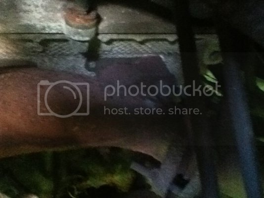

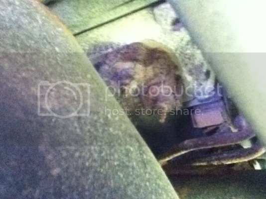

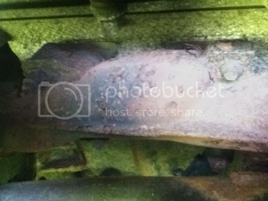

what happened to make it so you couldn't do it? and can you take a picture of the stock manifolds so we can see how bad they are?
here are some pics I had from a previous post. I honestly dont think they look as bad in the pics as they are in person. But I guess I also didnt have the right tools to get them out

It looks like a typical manifold to me, not extra rusty (maybe I am just used to working on Jeeps!). You can do this man! Just get to it, be prepared for it to take a while, take lots of breaks and don't allow yourself to get discouraged.
As mentioned, those bolts are very likely to break, NBD, you can remove em after the manifold is off. This is the fun of working on trucks!

those don't look bad, I did mine on Jack stands in my garage, took about 5hrs, mine were rusty but not as rusted as yours and never had any issues. Time and patience is your friend.
