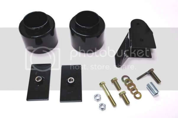

It is going to look sweet...when you get ready, call performance lifts ask for Jeff, tell him the site where you post, he will direct you to the front SPACERS, the springs are for the 4.7, the spacers he will provide will make it perfect, then get the rear kit, it has the drop bracket for the trailing arm in the back,here is the rear kit

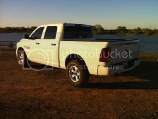

i tried the wheels/tires on for size
they are 305/65R17 on 17x8.5 wheels with 4.5" backspacing
no rub at all.
pictures kinda suck, it was getting late and they didnt come out real good. its still going in monday for the lift. stay tuned.

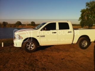

well here is a teaser! i picked it up last night around 9pm and went to the alignment shop around 7am. it is almost level. i think the front is a little bit higher than the rear. i went with 4" spindles up front and 1.5" optional spacer for the rear. they wanted to sell me a 1" but i asked for 1.5" i think it could use a 2" spacer. oh well still looks good. the driveway in the pic is not level so it looks worse. i can deffently fit a 35" tire now! but i have brand new 33"s oh well more burnouts will cure that!
WhiteExpress
Sep 8, 2011
18,187
3,284
Midland, TX
Loving the height! Those tires look tiny under there (side shots make it worse than it really is)

after getting it back from the alignment shop it doesnt look that bad. yes the front looks taller but CST claims that it is even. o well i dont care it looks ****!
