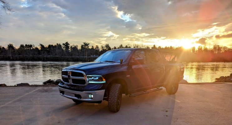

If the plan is to keep stock sized tires, I wouldn't go over a level. The tires will look small with a level. Adding 4" to the front will make them look ridiculously small. I'd suggest going with fox 2.0 front shocks and set them for 2" of lift then add 1.5-2" rear coils from zone or tuf truck. Add in some.better rear shocks from fox or Bilstein and you'll have a better riding setup that will look good with stock sized tires. This is what my truck looks like with 2" front lift, 1.5" rear spacer and 275/60r20 Goodyear duratracs. If I do anything different, it'll be better shocks and new rear coils instead of the rear spacer and rough country front struts. I'd seriously focus on ride quality than maximum height.

Hello and thanks for reply ... if you look the pic of my ram , it's already 2" on front and 1" rear with stock tires . My question is if i lift other 2" on front and 1" rear if this 275/60r20 will be good .
Unfortunately I have no choice and I have to keep the tires stock, in Italy it's not like in America.

First off, the answer to that question is an opinion. To know what your opinion about it is, take these simple steps….get 2 jacks and jack the frame up 2” in the front and 1” in the rear and step back and look at it.
