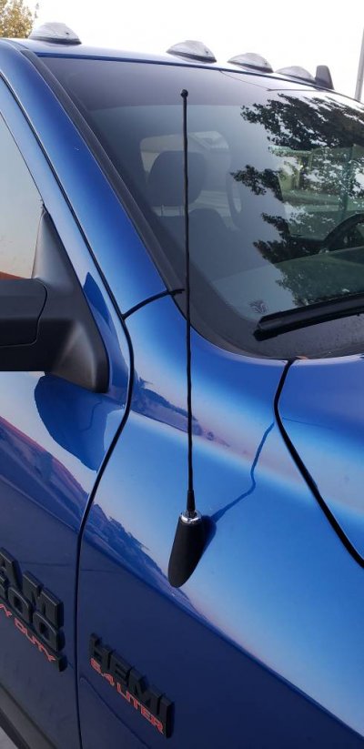

Screw it. Snapped a pic now.
Not much difference. Once you've seen one cut stock spray painted black antenna I'm pretty sure you've seen them all. Lol1a24358668b6c16fe386903e0f2f8428.jpg

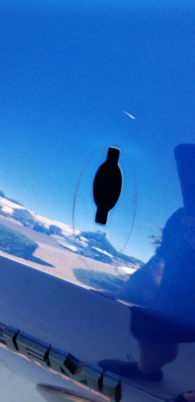

So, take the Ol PW through the car wash today and some how, a thin spinning piece of cloth breaks my stubby antenna. Try to take the piece out and the sucker won't turn. So unscrew the silver retention plate on the antenna piece to try and get a better grip and WHAM! Soon as retention plate comes off, the entire antenna assembly fell into the fender... Now I can't find the damn thing to fish it out. Short of taking the fender off, which I'm not gonna do cause truck is under warranty and that piece shouldn't have fallen down in there cause I know that assembly has 2 hooks, does anyone have any ideas? Otherwise, it'll go to dealership to get taken care of. dc7ac3c469ff789408eba09bb73d7070.jpg36e45534c32e92c95a4a755844a352ea.jpg
