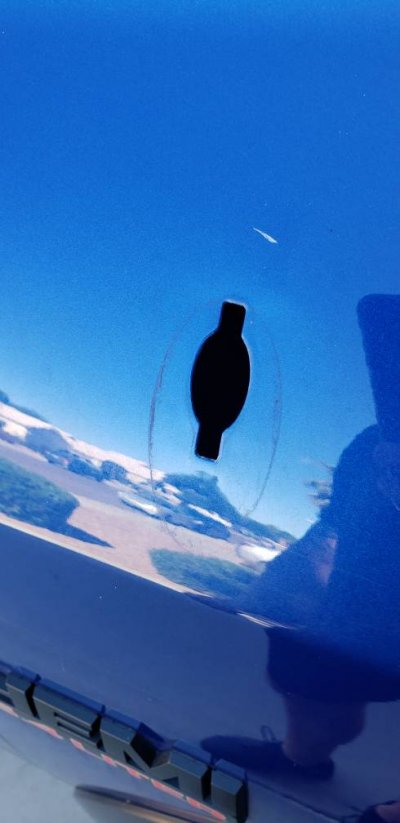

So, take the Ol PW through the car wash today and some how, a thin spinning piece of cloth breaks my stubby antenna. Try to take the piece out and the sucker won't turn. So unscrew the silver retention plate on the antenna piece to try and get a better grip and WHAM! Soon as retention plate comes off, the entire antenna assembly fell into the fender... Now I can't find the damn thing to fish it out. Short of taking the fender off, which I'm not gonna do cause truck is under warranty and that piece shouldn't have fallen down in there cause I know that assembly has 2 hooks, does anyone have any ideas? Otherwise, it'll go to dealership to get taken care of. dc7ac3c469ff789408eba09bb73d7070.jpg36e45534c32e92c95a4a755844a352ea.jpg

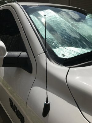

A number of people have done that one. You use a padded set of pliers to twist the ball off the top, cut the antenna down to where you want it, file the end down to size and push the ball back on. It screws up your reception, but so does a shorty. It also removes the inbuilt "this area is not tall enough for my truck" detector (there's a reason the antenna is 2 inches taller than the truck).

Is there a write up on how you did it? Did you paint your antenna black?
Yes I painted it black after I cut it then put the ball back on. After it dried I reinstalled it on the truck.

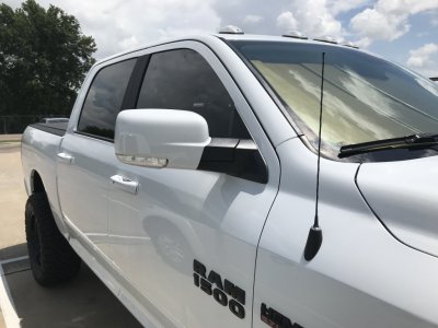

Just snapped a few new pics and realized I haven’t touched this antenna in almost 2 years (06/17 - 05/19)
