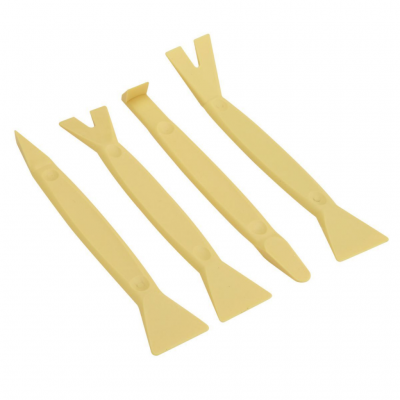

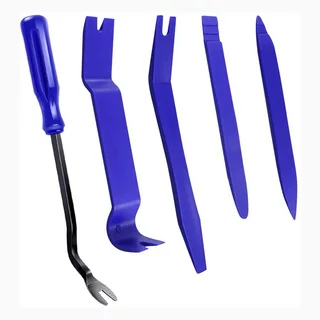

The second thing, is to purchase a cheap set of Plastic body panel clip removers, as long as you own your Ram, they pay for themselves.
Plastic tools help to protect the door panels from getting scratched
Harbor Freight
Walmart
Home Depot, Lowes, Autozone, etc.

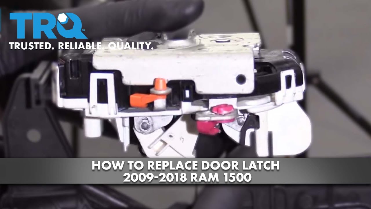

Hopefully, you will not have to ever replace the door actuator, but this will show how it is done.
I helped the Body Shop do my 2016 Passenger side actuator
