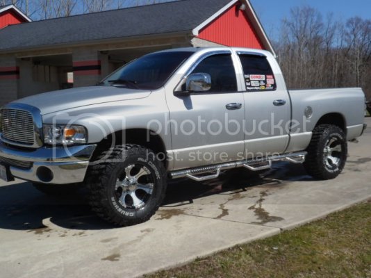

here is mine leveled 315/70/17. 4.53 backspacing on wheels. still get rub at full lock when i hit a bump while turning.
