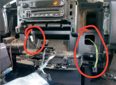

Need help identifying these wires.
Its a 2003 ram 2500 SLT QC/LB 4x4
Wire on left is
Black-black/yellow
Wire on right is
Purple/yellow
Purple/yellow
Green/yellow
Green/red
They are not connected to anything. And i would love to know wuat they are and what the wires correspond to.

The one on the right doesn't get used since you have a QC, it's for RC's to turn off the airbag for child seats. Should be a corresponding blank on the back side of the bezel off to the right that it plugs into. Left one looks like the lead to the ashtray light; does yours have a functioning ashtray light?

No it doesnt have an ashtray light...so would that be a 12v lead ?
