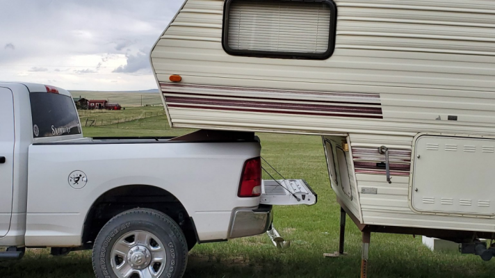

1) is the gooseneck part of the "OEM Prep" or aftermarket.
2) what is the campers overhang, I have an older than dirt ('95) 26' camper and I can jack knife without a worry on the rear window on a 6'4" bed
I bought a curt 15k slider for $150 on craigslist and $350 rail kit & bed wiring harness from etrailer.com (great company). Not too bad to install the rails, but the rails are pretty much universal. So yo can pay to get those installed (like I did) and then hunt around for a good/great deal on the hitch itself.
Slid back. I can't close the tailgate so with it down
Slid forward.
