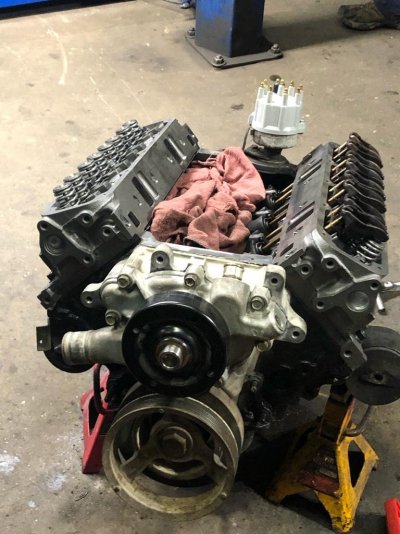

got her back today .... thay dropped the box and put a dent on the bottom of the quarter but nothing i can't fix. .. and a few bucks off the bill. ... new to me engine. .... it don't seem to run as strong as the one thay took out but runs real good and smooth.... but it still has all the rods still in it and 65 psi of oil when warmed up so im good with it. my engine had red injectors in it this one has black. il put the ones from my mill in and my MSD coil that should help. all in all spent 1300 bucks for a mill new clutch new seals and gasgets and a box instaled and drove away. ... not a bad deal

changed the oil twice in the ram sence the new mill was put in it. ... took it over the mountain and brung back a zero turn and a trailer load of stuff worked fine. .. pulled the plugs just to get a read on how things are .... nice light tan color. .. pulled nice up hill and all that (after i put the red injectors back in it) .. all in all im happy with it. ya never know what ya going to get with a used engine.

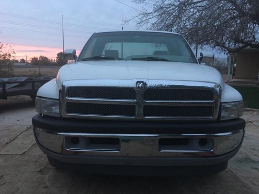

Installed a new bumper cap. Front end is catywomous...so something is not straight. I think it is the grill. Broken grill attach bracket.
