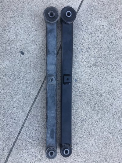

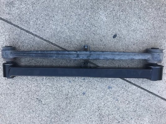

Got Mevotech surpreme rear control arms installed. The bushings while not new on the old ones (truck has 80k miles) had still some more miles to go.
I'll wait another 20k miles or so to resfresh the front LCA's, tie rods, etc.

The sleeves certainly look like a better fit vs the OEM oblong, any difference in bushing durometer?

I'd like to think there is a difference in the bushings since it was refreshing to see the sleeves are an upgrade, and the control arms body are an upgrade.

Maybe 1/4" longer, but the OEM bushings look like they split on both edges in that photo when you zoom.

Maybe it's just the angle of the pic but it looks like the stock arm is slightly longer here.
I think somehow is the angle of the picture though i didn't measure eye to eye. but check the other one where i tried to lined the holes up and the difference is pretty much nothing and should be the same.
Something interesting though if you look at the arms on both ends there is a small end and a big end on all the arms. The small ends seem to go at the axels while the big ones go to the frame side. All the same except for the rear passenger lower. In my case the small end was located towards the frame while the big one was facing the axel. I thought somehow that could have a been a mistake, so i ended up locating the big end towards the frame to match the pattern on all sides, All the stockers have marks indicating frame or axle and in the passenger one that one was marked frame. Weird.

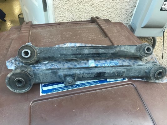

Actually it seems i made a mistake, I kept thinking about why the differences in both ends so i recovered the arms from the garbage bin and took a picture of them
The lowers have the frame side being the small end, while the big end seems to indicated axel.
So i guess i'm going to have to rotate the lowers because i put the big ends towards the frame/front of the truck.. the uppers are reversed and the big ends go to the frame. Damn it.
Lowers
48757002696_f39da63085_k.jpgUntitled by RAM RSM, on Flickr

And i have corrected the mistake and installed them like the factory says. don't know if having them the other way would have done anything different but what that heck :)
