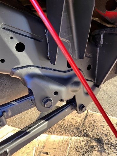

The great white and salty Canadian winter is coming so I spent some time this weekend (aka the entire weekend) working on the back 1/2 of the truck to remove 8 years worth of Krown and crud before it goes in for another coat next week. The frame itself was in excellent condition underneath the built up oil, with just the edges of the metal having surface rust and peeling. Honestly, it was wayyyy more work than I anticipated, so I didn't even get around to cleaning off the underside of the box. I used a plastic trowel to scrape off the bulk of the gunk, then hit it with POR15 degreaser diluted 1:5, dried it with shop towels, scuffed it with scotch brite pads(wire wheels in some areas) and then used Tremclad Rust Reformer in matte black followed by Tremclad rust paint in semi-gloss. My recommendation to anyone else wanting to do this - don't be stupid, use a pressure washer to remove all this stuff. Regardless, as sore as I am, I'm happy that she looks fresh from behind again. Onto the main frame rails and front end next weekend!
Before:
After:
As you can tell, up under the box is still super dirty.
I've removed the spare for when it goes in to get undercoated next week. Also, the front end in the background is the same colour that the axle back here was! Can't wait to get it all tidied up.

Are you sure that’s the same undercarriage???
Wow……. Great job, and detailed. Amazing. That’s coming from someone with serious car/ truck OCD :favorites37:

Haha thanks man. Really excited to get the rest of the truck done.. but that will be a task for the spring. For now, it's going to be a mild fall week which will be ideal for another coat of Krown!
