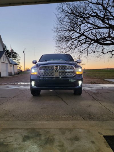

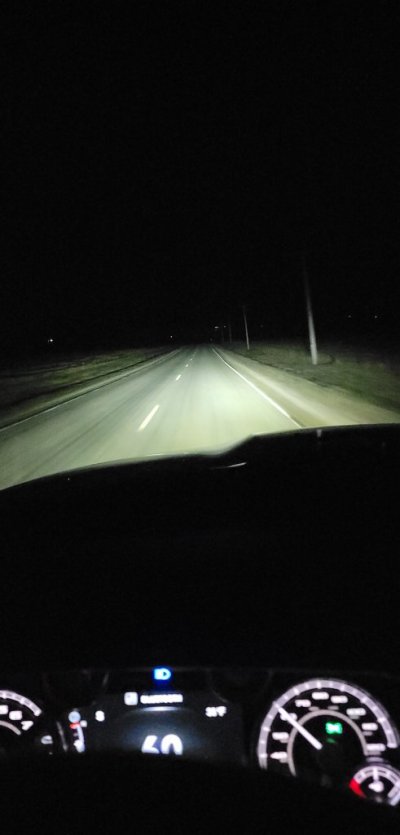

Swapped out all my lights for lasfit led.

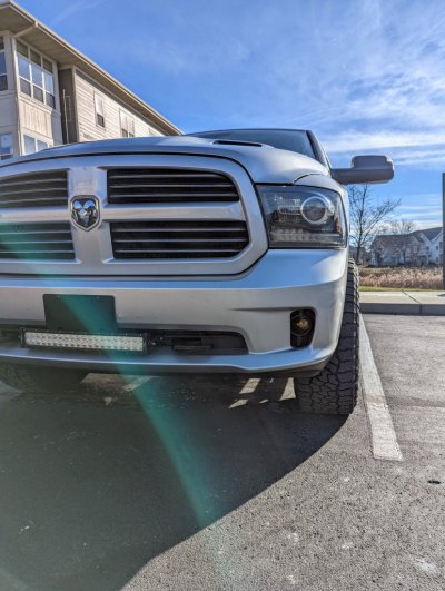

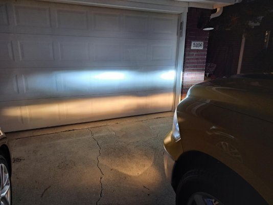

Got the Morimoto XB fog leds swapped in with the LaminX yellow. Also not pictured is I swapped my DDM high beam leds that wouldn't clock correctly for S V.4 leds and clocked them to the correct 3/9, what a pain, barely fit underneath the housing and the only way I could get them in was to take off the fan, get them in, then reinstall the fans.

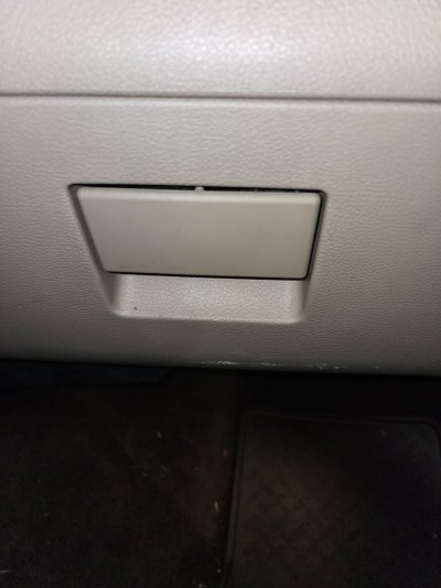

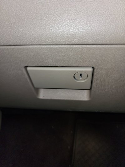

Bought the locking glove box lock handle from Mopar, painted it to match - SEM interior paint, keyed tumbler, and installed and locked it! Yep not a steel safe or anything, but deterant is what I'm after for this one. Works as expected!
Mopar P/N: 82211490
SEM Plastic Adhesion Promotor 39863
SEM Light Frost Beige SEM-6087 (my interior color)

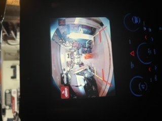

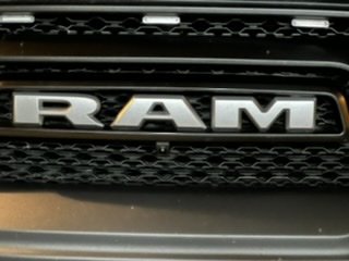

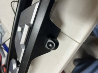

Installed a front cam. Found and installed solely from info on this forum. I really appreciate all the posts people make on their mods. The placement of the camera was my idea. That is all. Lol. I used Alphaobd for the first time on this mod. Again, read that thread for a few days.
Thanks to mp Grimm for his adapter made a huge difference. Fast shipping too! Thanks again!
