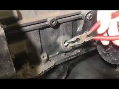

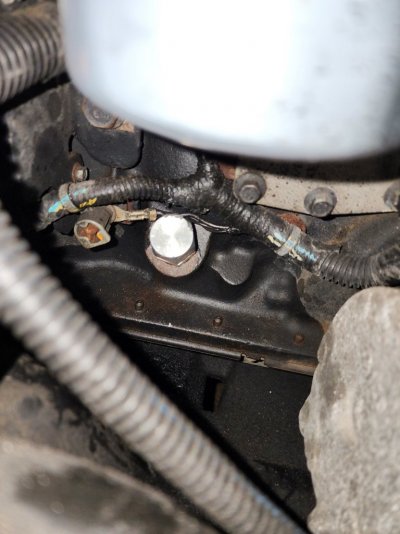

Installed a fitting into secondary turbo oil drain connection in block in preparation of putting in a centrifuge.
Used this method to remove the plug from side of engine block:
Used a magnet to make sure nothing metallic went into block. There is a ledge just inside that will catch anything just in case. Started out using wire brush while plug was in and wiping it down a lot as well before removing plug.
Used this fitting which includes cap:
Says up to 2007 Cummins 6.7, but fit my 2016 6.7 just fine.
Drain plug fitting only needs to be tapped in and once in its not going anywhere. Cap is included to tap it in as well as close it back up till you're ready to use it. This video helps show how to put in.
Am fabricating now a mount with drain connection to be hooked up to this now installed fitting. Centrifuge will sit on top. Will post more as I go.

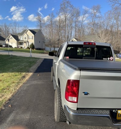

Series of events with my wife's low tire light in her Highlander reminds me to check Ram spare tire since I know the steel rim on it wasn't in the best of shape and had bought a rim to match the truck that had just showed up recently. Off to the tire shop for swapping spare tire rims and order my wife's Highlander a replacement as well. Didn't take too long and am back on safe path with both again, but doesn't help the wallet!
Actually aired up my spare today, it felt a bit squishy when I punched it. I was already all under my truck today anyways.
