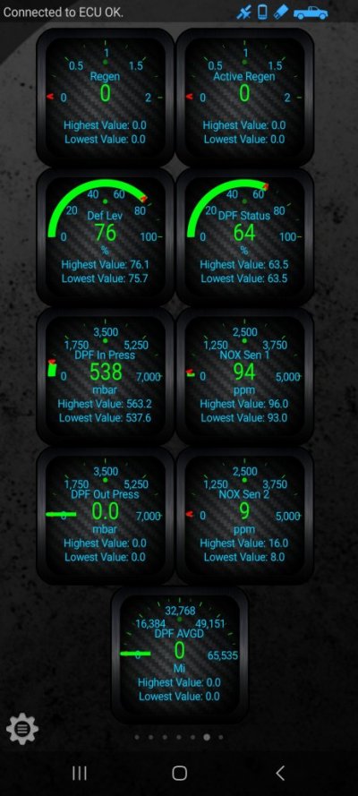

And now a "Service DEF system , see dealer" message with a P202E
Common Problems That Trigger the P202E Code​
  • DEF injector failure
