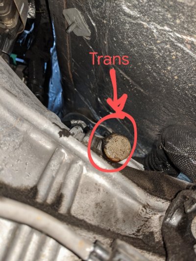

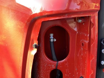

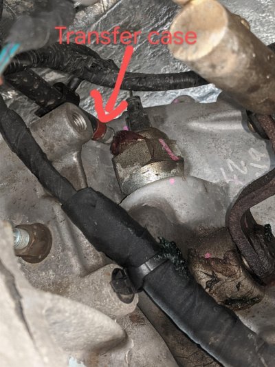

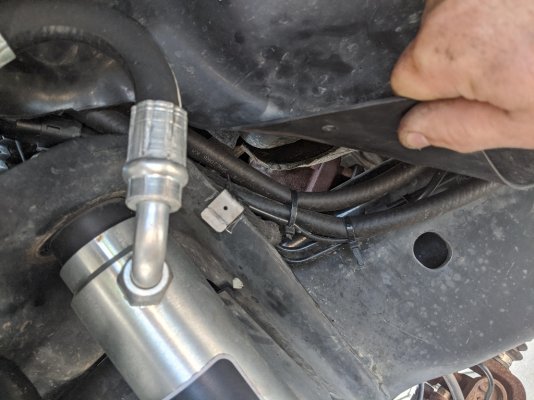

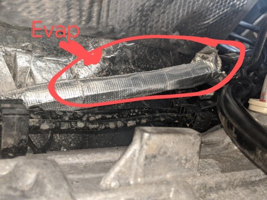

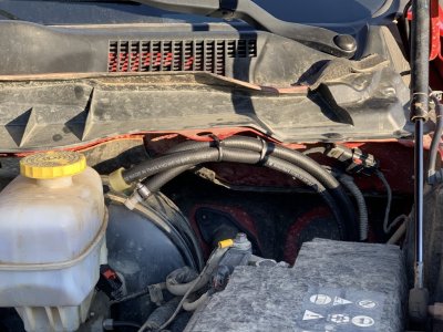

I followed @IRSmart lead and extended all of my breathers there is a total of 5 (front, rear axles, transmission, transfer case and evap tube)Youll need 3/8" I.D. hose for everything(approx 25ft) but the evap line thats 5/8" I.D. (approx 6ft) also a few male to male barb fittings. I used the barbs to add onto the factory lines for the axles and the transfer case. The trans is only a 2" stub so that needs to have a full run of hose. I ran the front diff trans and transfer case along the frame and up into the engine bay, evap went into the engine bay as well. Rear diff was extended up behind the D/S tailight. The trans is tough to find its only a little nub thats right on the too of the bell housing and the evap tube on mine ran along the passenger side of the trans wrapped in a foil heat resistant covering
Heres some pics to help, first three are loactions and the last two are just how i routed everything. Mind you all of this is on a 2017 so there maybe some variance. 29883981fb5694fbac42135926bd6e3c.jpg7535ba979fa9f2efb2774e272ba0171b.jpg2769137f9c6c9759d895b40883342044.jpgce0c3dc16a21bd8409d0a6dea38201c8.jpg816a25a71beb5e05b549ad7fcf29d03b.jpg

My extensions basically mirror @Maligator . I ran the four breathers up to the engine bay and the rear diff up behind the driver’s tail light. I used brass barb fittings and with hose clamps to make sure nothing ever came undone. I added onto the factory tubing instead of replacing them so I could use less hose. The only one that’s a bit of a ***** is the evap line, since it’s not really a hose that you’re extending, it’s a solid plastic tube. You have to cut that tube, use a new hose clamped over the stub you leave behind to extend it (which is why it is a different diameter than the rest of the lines), and clamp onto the mushroom that you cut off to be the breather at the end. I used all the factory breathers, I didn’t purchase a kit, or use aftermarket ones. No pictures of factory locations, but there’s a really good post on power wagon registry that shows diagrams of the truck’s components with arrows showing where the breather tubes come out, that’s what I used for the transmission and transfer case. The evap is a bit more of a ***** to find, I had to follow the line all the way from the evap canister to where it ends on top of the transmission on the passenger side to find the breather mushroom.
