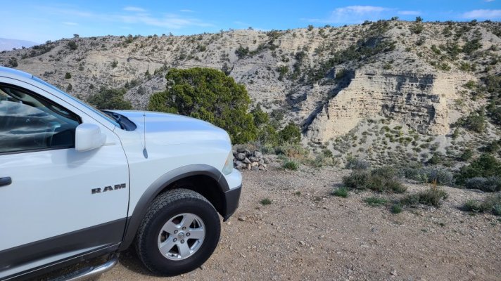

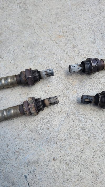

Changed O2 sensors. Had intermittent P0420.
The two number 1s had melted ends.
Drove it about 120 miles today and the code cleared. Went to about 7500 ft elev, up Lee Canyon Road and out to Indian Springs and back. It cleared about a mile from home. 20240419_155358.jpg20240419_155434.jpg20240419_160501.jpg

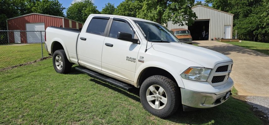

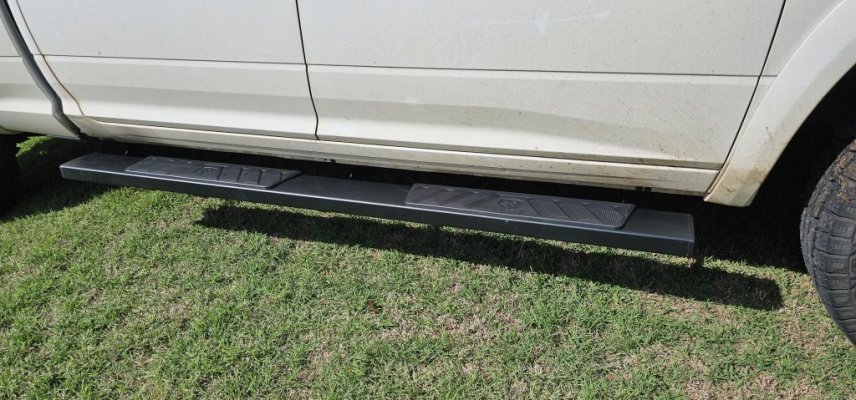

This week I put on Steelcraft nerf bars, and right now I'm getting the permaplating put on the truck. This way it gets a real good bath.

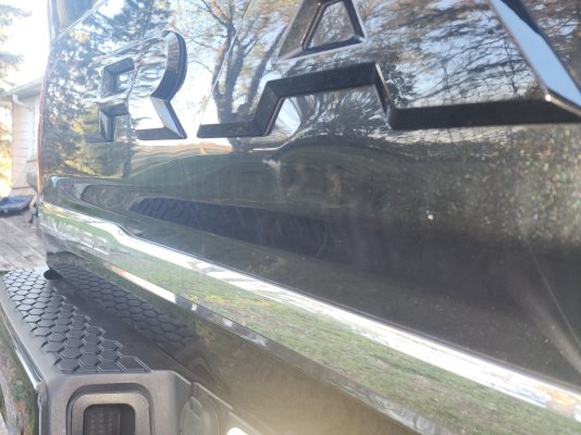

Not exactly sure when it happened, but noticed it yesterday. I'm not even sure what happened because there's 2 dents inward, and the center is creased outward and cracked the paint.

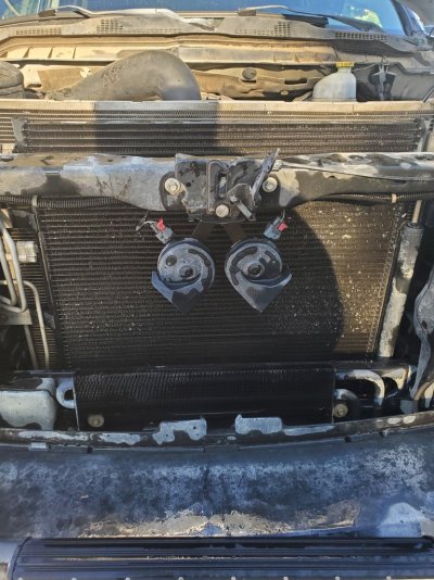

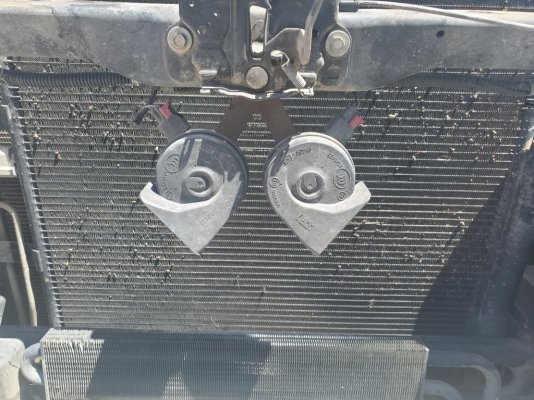

Took off the grill and cleaned the heck out of the condenser and radiator. They were filthy!
It's about to be 120 degrees where I live so I wanted to be ready.
The ac seems to cool off way faster and gages say truck is running 3 degrees cooler after the cleaning.
