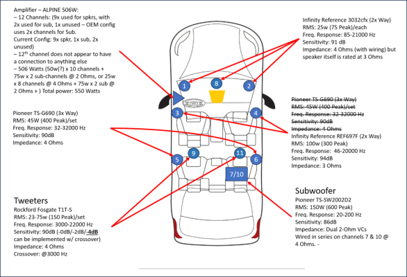

I initially installed, tested, and then removed an Infinity Primus PR-503 in the front left door. It isn't a very good speaker for that position IMHO, so instead I installed a pair of Infinity Reference REF-697F speakers in the front doors to replace a pair of Pioneer TS-G690s (one which had blown on the low end). Left the Pioneers in the back doors alone for now. Might replace them with something from Infiinity later - haven't decided yet. Sounds louder than it did with the Pioneers and definitely got some more bass out of it. Attached is my current setup.

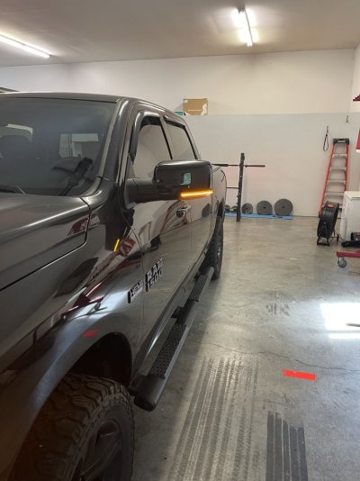

Added Morimoto mirror lights
