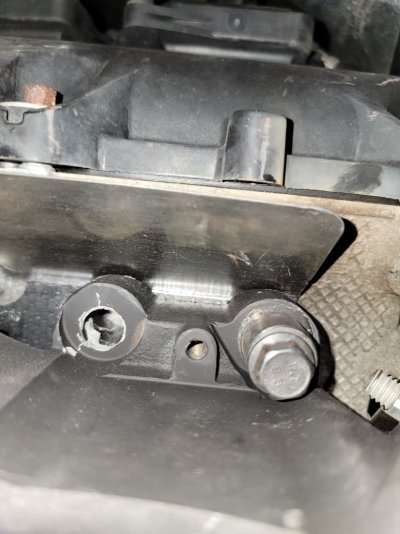

So shop just messaged me and said oil is changed,but I have a broken manifold bolt at the back of the driver side manifold and they didn't feel comfortable doing the work. Probably because I put them on and the bolts are proprietary maybe? Anyways, I have only driven the truck for test drives since install due to the noise I heard. I am beyond comprehension how I snapped a new bolt on short test drives. No issues with passenger side which I also did in April. FML! I think I do have extra bolts, but can't for the life of me understand how this even happened. Their system has spacers to allow expansion to keep this from happening. Maybe just a bad bolt?
Edit
So after reading the invoice it said bolt missing. The driver side manifold is made for 2 different bolt configurations and the hole near the rear he's referring to does not get a bolt. So itlf that's the case it's the collector leaking like I told them. Wtf?!?!

So after picking up my truck and getting it home I checked with my phone and sure enough the mystery bolt missing is a blank hole not used. Going to fix the collector leak after work. 1000002127.jpg
