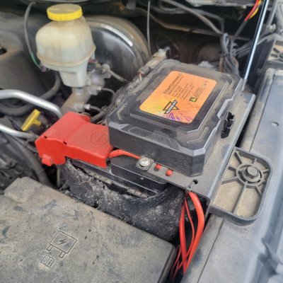

I really like it. It makes wiring in accessories a lot easier since I only had to run one cable into the cab. I used the brackets that came with it. The switch panel sits in a magnetic 3D printed holder. Here's where I installed the controller. Sorry for the dirty engine bay.

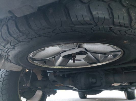

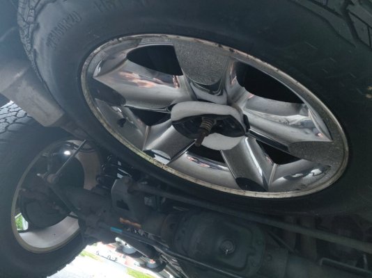

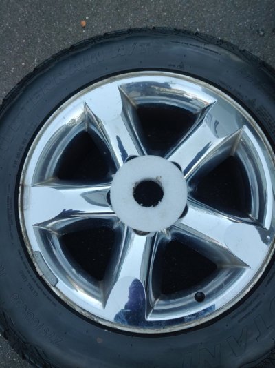

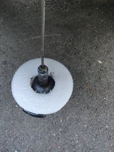

I upgraded my compass module to one with Homelink. I also modified a chrome clad 20" wheel, so I was able to IMG_20251027_174726.jpgstore it as my spare under the truck.

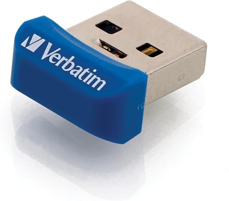

Spent $50CAD on a used iPad, uploaded my music library, plugged it into the AUX USB port in the RAM's centre console, and shut the lid. No exterior mess, and music is now selectable through the standard radio console menu.
Cheapest alternative to CarPlay you can get!
I have always just put my music on something like this, and left it plugged into the usb in the arm rest.61pYZ-CzMSL._AC_SX679_.jpg

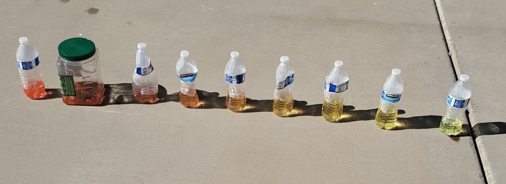

Did coolant drain and fills. The fluid I drained had either 97k or 107k. Still looked good and ph and freeze protection were still ok, but changed it based on age and mileage. Put in valvoline zerex g05 hoat. From left to right is the first to last drain, with the far right being brand new fluid. . The last two drains there was very little color change. The fluid on the 8th drain was just a hair darker than brand new fluid, which is good enough for me.
The process was easy, just took out the thermostat, reinstalled the gasket, and ran each fill for about 10 minutes to circulate it. Then drain and repeat. Probably could have used distilled water, but premix is easier and Napa had it as a monthly special.
