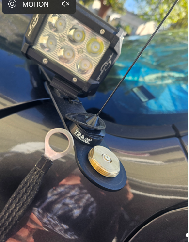

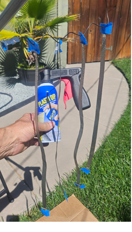

FINALLY properly grounded my CB and UHF/VHF antennas to the hood and frame since the powder coating on my Ditch Light brackets were not providing a solid ground plane. Made a huge difference. Now the whole body and chassis is one linked ground plane.
I been trying to get to this for a couple of months and knocked it out today.
Note to CB and UHF/VHF installations and ditch lights. Highly recommend braided mesh grounding.
To protect the hood edge paint and for looks, I used Plasti Dip spray paint to cover the flexible metallic mesh. It REALLY HID the mesh visually when zip tied to the existing coax and power for the light..

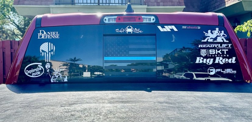

Good day to all,
Some updates on this end.
Installed custom 5th Gen Grill via https://sktcustoms.com paired with some Auxbeam 3" Pods also added some 3" Ditch lights tied to Auxbeam 8 Gang switch panel inserted into a Flipit 3D housing
Installed custom amber grill lights via https://www.mad-baboon.com
added some more custom vinyl stickers..
