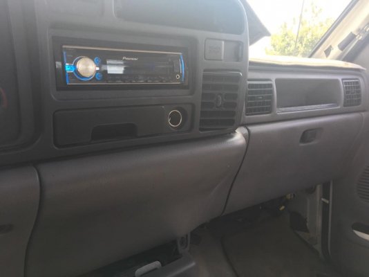

I purchased a used “under dash” ( what I call everything that’s plastic and not the top of the dash) on eBay. I tried gluing and epoxying and finally decided that if I want o keep the truck I’ll have to fork over big bucks for the under dash. I think I paid $720 for one that included shipping.
You have to remove the entire dash assy. The under dash is rivited onto the metallic dash frame. You’ll have to drill those out. I installed my new dash with screws and lock nuts. I didn’t have a rivet tool so the screws worked well.
I bought a new dash top and bezel from LMC Truck.
It was an expensive project but really changed my truck for the better...
I also painted the used dash and dash top with Colorbond paint (LMC Truck)
Finished product:
