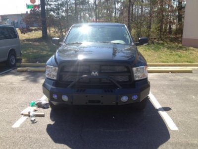

What does everyone think about a PLS600 5" BL kit for my truck with bilistein 5100 on front and back. Tries I'm looking at is 35x12.5x20 nitto grapplers trails.image.jpg

Did you say 5" body lift? Are you trying to show off your frame rails?

Isn't that going to put your HD bumpers well below where they are in relation to the body?

You shouldn't have a problem as long as the bumpers mount in the same place as stock, but your bumper does have to be lifted I'd imagine as it is bolted to the frame, and the rest of the body of the truck moves up.

That's what I was wondering Gibby.. I always thought it looked retarded to have a body lift and the bumpers 2-4" below where they should be in relation to the body.

Don't get spacers + Bilsteins. Just get the Bilsteins and a 3" BL.
Also, while the BL might have 'adapters' for the factory bumper, I'd bet they won't work very well for a beefy off road unit like you have.

If you want to put a winch on that big ass bumper or use the tow hooks, you'll need to leave it where it is, body lift bumper brackets render the bumpers useless for towing or otherwise

Love the bumpers!! Where did you pick them up and for how much ??

With those badazz bumpers you might as well get a susp lift

They are Boondock bumpers. He is the guy that designed the Iron Cross bumpers and side steps. He left that company and started his own business. Great company and great prices. PS I got mine free won a Military Appreciation Contest. but for front and back I think it was like 2500 you can get different versions and painted to match if you want. Great product.
