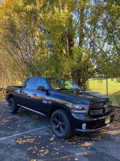

Just bought a 2016 Ram 1500 Sport. Online it looks like stock would be a bi- xenón or something headlight? I long care for the amber color and would prefer all white. Is there an easy way to determine exactly what i have per a vin number or what i need to change these out? Truck seems to have had a blackout ish package done to it from the factory, per some of the options on the truck. Thanks for the help

Those are the projector headlights. The bulb itself is a halogen unless it's been modified. The "Sport" package has the options you are talking about- projector headlights, hood "vents" and black wheels.

Will give U factory build sheet, not ne mods done.

They come factory with halogen bulbs in the projector low beams. You can switch to a good Sylvania bulb, whiter and brighter than stock. Hid's normally will need some mods or add ons to work but they too are much brighter. Led's, well i think until they get the beams focused properly and no need for resistors or alpha change, I will stay away from them. Luckily I seldom drive at night, so the halogen's work great for me.
