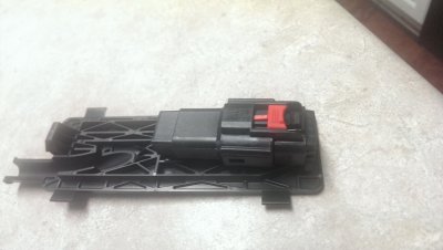

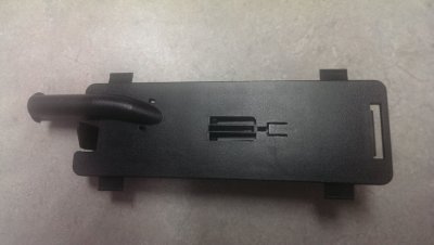

Hey guys I'm new here! I just purchased a used 2014 Quad cab on Friday and this was in the glove box. This anyone know what this is and where does it go? Thanks!

Yes! That is for when you remove the tailgate if you need to. This plugs into the harness you have to disconnect for the rear view camera and power lock on the truck....
You will get errors if not connected as the truck will be looking for the camera.
