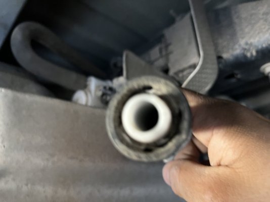

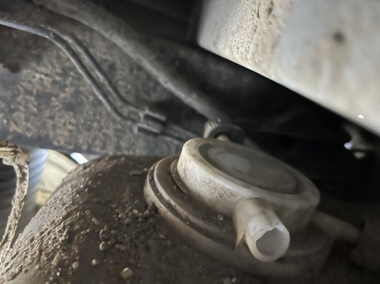

I found this plastic neck broken. I want to order a new part but am struggling to find what piece it is. I believe it is on top of my fuel tank. I have attached photos for reference. Any ideas on what it is?

It is on the rollover valve, and they break when you breathe on them just a little! ;). You will likely have to buy a new tank, because that plastic hates EVERY type of glue I've tried!

Hhhmmm…if it were my truck I’d be slipping a piece of hose and a hose clamp on the stub and splicing it into the line…

you cant! It breaks off (as it did here) right at the support molded into the fitting, thus, there is no way to slip rubber hose onto the stub. Believe me, I tried on a fuel tank which cost over 800 dollars 4 times. None of the adhesives worked.

The old 2 part original JB Weld will stick to it,especially if you rough up the pieces slightly with sandpaper. And no you didn't try it,so don't try and say you did,lol

I don't use super glue, period. The 2 part epoxy is EXACTLY what I used the first time, and I let it cure over night.
The problem WASN'T the glue. The problem was the way that fitting was originally molded with a bolster under the tube part up to the outer perimeter of the circular upper body of that roll over valve.
It just would NOT adhere in spite of me roughing the plastic up with sand paper. SO, I machined a small piece of aluminum and drilled it out to provide reinforcement to the whole thing, cleaned out all the epoxy, and re glued it.
Since the molded hose uses a quick connect which must grip the tiny flange molded into the tube, MOST of the epoxy must be removed to get the outer diameter down to where one can push the hose back onto the fitting and not encounter interference, and the bolster underneath made it VERY tough to accomplish.
Two more attempts made me advise the customer to just go ahead and buy a new tank. A new tank solved the problem, albeit expensive. This was the 2nd of that design which attempts to patch that same fitting failed.
About 2 months ago, I had a 2013 Ram 1500 4-door crew. I was replacing the fuel pump, and nearly danced a jig when I was able to get the hose off the fitting without breaking it off. (They are extremely brittle with age and use.)
Luck ran out, however, when I attempted to re-install the hose, ever so deftly. It snapped off.
In THAT case, I machined a piece of aluminum, but longer this time, and plastic welded the broken piece. I had to tweak the outer surface with the hot tip (It resembles a soldering iron) so I could have clearance for the quick fitting. The truck has been fine since, and has passed EVAP monitor.
That first attempt was on a 2012 Jeep Wrangler 4 door 3.6.

And there's your problem 2 part Epoxy is "Not" JB Weld . 2 part epoxy is basically useless on plastic
