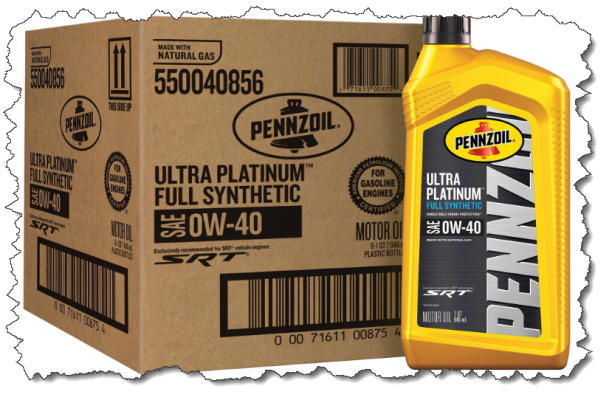

I'm currently using Pennzoil Ultra Platinum 0w40 with that tiny oil filter Mopar recommends. Changing every 2000miles until I get 10k on the odometer. I've always used Valvoline oil in my vehicles and Champ XL filters. It seems like most of the 0w40 oils are Euro blends and I'm not sure if they're okay even though they appear to be SN or SP rated. I'm also considering running 5w40 in the summer months since it has better shear stability. I change my oil and filter every 4k miles and am wondering what everybody else is using. I'd also like a filter # if you've found a larger filter that fits the 6.4.

Pennzoil Ultra Platinum 0w40 meets MS-A0921 spec and it can be used year round even in cold upstate NY so not sure why your worried, as for oil filters IMHO there are better quality oil filters for you to use, what one is up to you, royal purple, fram or fleetguard..

I use:
And Lubegard Bio/Tech Engine Oil Protectant.

My biggest concern is the oil shearing out of viscosity. It's my understanding ( according to Lake Speed Jr.) that 0w40 oil regardless of brand is more prone to shearing than other multi- viscosities. I guess I may be worrying over nothing since I change my oil every 4k after break-in. As far as filters go Champ is as good as any other filter out there when the oil is being changed at regular intervals. They actually make some of OEM and other brands filters and are owned by the same company as Fram.

I ran 5W-30 Redline with a Royal Purple 20-820 filter on the wifes 6.4 Challenger,and it was definitely happier on it then when it was on PUP 0W-40 and the Mopar SRT filter.
Car was also on a 50 shot of nitrous,and she beat the living hell out of it on the street and at the track,up till she shattered her leg,she was racing it every week-end,and doing a fair bit of street racing with it.
