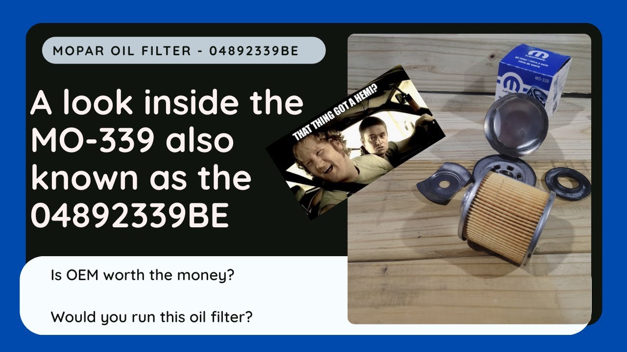

Just got mine changed again on Friday and this is the filter they used...
This guy doesn't have a problem with them...seem well constructed to me.
Well I can say cutting any oil filter open will not tell you much the filtering media, how well or with what size of particles its is keeping trapped inside the filter, how much it the media can hold or what its not trapping in the filtering media...
