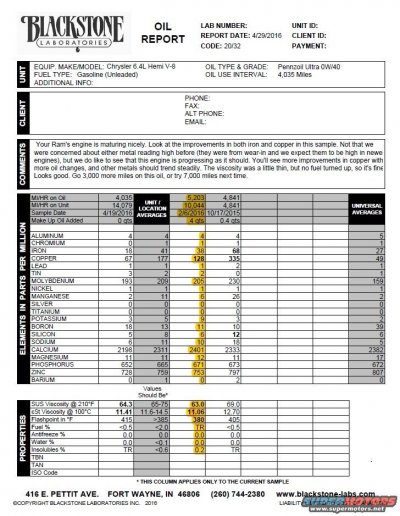

just to be clear, being that the VOA is over 3 years old I dont think this is the new "Pennzoil Ultra Platinum" formula. It looks like the "ultra" before the did the PUP thing. Am I correct on this? I know they improved the packages on the PUP over the original "Ultra".
Attached is my oil report. The highlight one is the latest PUP with the far right the factory fill.
With the exception of wear metal, it is pretty close to that VOA sample of the older Ultra formula. Only exception I see is the is the newer PUP does shear ever so slightly out of grade to a heavy 30wt.
The last sample was a one time experiment I did running 4 quarts of PUP and 3 quarts of 10W-40 PYB conventional trying to see if I could keep it in grade but that did not work as I had hoped. Current fill is back to 0W-40 PUP.

so can anyone shed some intelligent light on this UOA?

Like how does it compair to like M1 0w40?
Has about 1/3'rd the moly of PUP and more boron. Everything else is about the same. Many people have been running it in these engines with no problem. If not in warranty and squeezed on getting PUP, I would use the Mobil 1.

Why is moly so impoerant in the 6.4 and the 0w40?
Or is it normaly important to have a lot of it and a good oil?
Molybdenum Disulfide over time forms a lubricated coating over parts and fills in microscopic pores and valleys in a given metal.
I am not an expert by any means but there is some notable instances of cam failures of Hemi 5.7's with the common denominator of very low or no Moly oils used with Valvoline being a big culprit.
I am not privy to FCA's engineering and even though there is public statements that conventional 5W-30 was used during the RAM 6.4's development, they eventually spec'd 0W-40 and not just any 0W-40 but one that meets their MS-12633 specification and PUP 0W-40 meets that spec with a high moly count.
