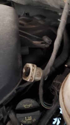

V6 3.6. I went in to get the plugs changed in the winter. nothing at all has been wrong with the vehicle. Has been running well. I popped the hood today to clean the intake and this piece is already out.
Maybe the dealer didn't hook it back up. It's dirty now. What does it do? Should I plug it back in? What happens if I don't. Any info would help.

Can you take a pic of what the connection is attached to? Is it attached to tubing or wires? My first guess would be the PCV fitting attached to the air intake given the crud on the connection, but I’m not familiar with the engine layout.
Have you followed the connection back to where it leads or looked for where it might belong? Is anything missing a connection, possibly underneath something that’s not obviously visible?

Does it the back into the wiring harness that is above it or does the picture make it appear that way? I agree with Sandevino with his advice. Look at the metal connections inside of the plug, even though it has been unplugged for some time and it's dirty on the outside if it was ever plugged in there should be visible signs of that on the metal connections inside the plug (no heavy corrosion). My advice would be this......you say it's been unplugged all along and everything has been operating fine? Don't poke a sleeping bear, leave it be.

The tube that it plugs into is right there. It looks like the pcv because it attaches to the air intake. What's detrimental to the system if this isn't attached. This probably hasn't been attached in months. Should I continue running it without it plugged in? Doesn't the pcv give me oil blowby anyway which isn't great for the motor as it is.

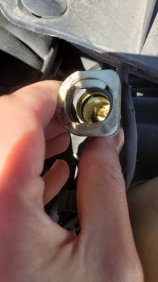

Can you take picture of inside plug, and one or two more of the sides? It looks like it slides in somewhere.

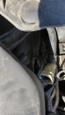

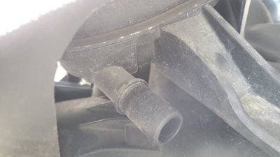

Here we go. Pretty sure it's pcv. But again, I'm not sure what's good or bad about it being plugged in or not.

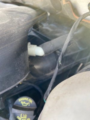

Just took a peek at my son in laws V6 Ram, it appears to connect to the back side of the engine cover, looks like it simply clips onto the access port. Maybe clean it up and try to connect it ? Hope it helps pic2.jpg V6 PCV.jpg

If that's the PCV its job is to draw gases out of the crankcase - without PCV these gases and vapors (blowby, volatiles that cook out of the oil, water vapor) will condense onto the inside of the engine anywhere that's not in constant wash by the oil and lead to built up crud and also dilute the oil & may cause it to become acidic.
I'd rather burn that in the combustion chamber and send it out the tailpipe than let it accumulate in the crankcase.

What crossmi said... it goes on the open tube in your middle picture.. make sure you push it on far enough so the white clip holds it on though
