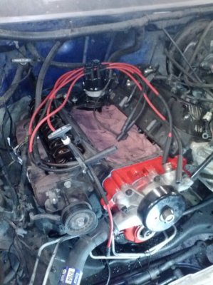

I'm assuming your asking why change the oil? Because even though you drain the coolant before removing the intake there's is quite a bit of coolant that will drain straight into the crankcase once you loosen the intake and it will usually drain out when you lift the intake at an angle.
Most don't do this is why I said it. After a timing cover or intake this should always be done.
Once your done drain the oil, water is heavier and will come out first. Most of the time you'll see it run green for a second or two.
The other thing I do, lay rags in the valley while cleaning the head surfaces to catch the debris then carefully lift it out then use 1 qt clean oil to was the coolant and small debris into the pan.uploadfromtaptalk1427260496204.jpg
