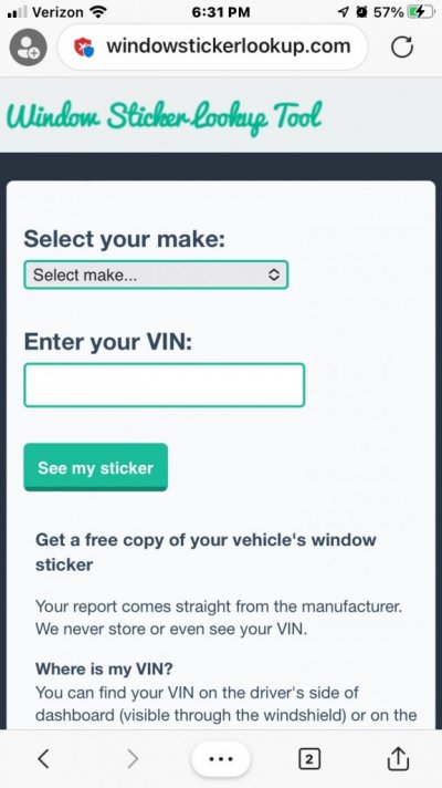

You can tryWindow StickerLookup Tool website. Nice looking truck.

I’m sorry that website is Window Sticker Lookup.com. It will tell you numerous things about your truck.

You can put the vin in here, it will tell you what the truck originally came with
Badass!!!!
Thank you, looks like we have a 5.2L V8 OHV 16V : )
