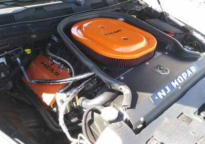

This is the only Vararam I know about, guessing it's the 'under glass' model.
