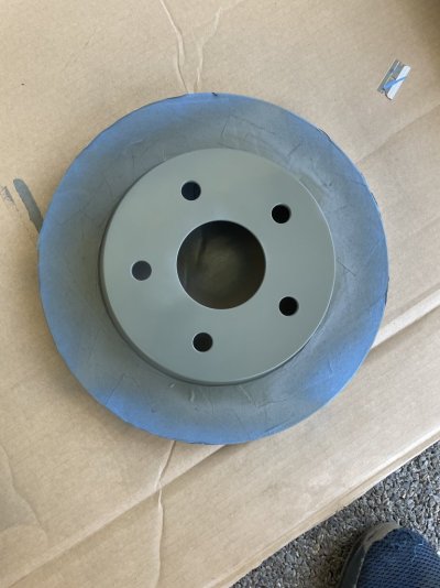

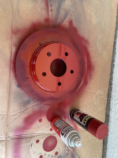

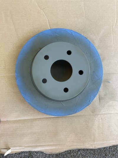

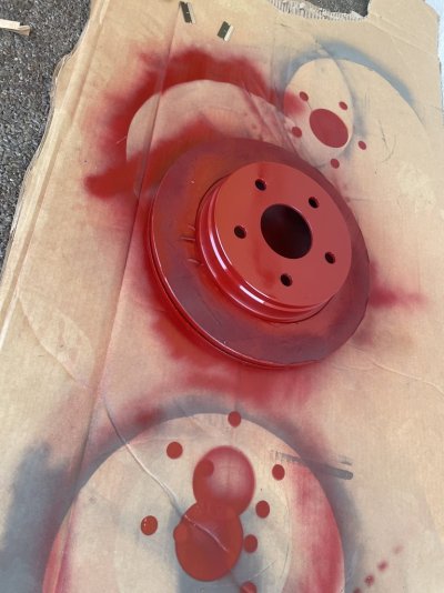

This entire project has been very involved. I bought these power stop Z 36 package about a year and a half ago. I might’ve had 15,000 miles on the truck and a lot of that was highway.
I cleaned up these rotors and got rid of all the rust on all surfaces. I even used a small wire brush on a drill to clean in between the vanes along the outside edge. Then blew everything with a compressor.
I use the self etching primer. Couple of coats. Then they use the red VHT caliper paint. To sort of go with the power stop calipers. I will remove the blue tape tomorrow on the flat part of the rotors.
Going forward are there any companies out there that make really good rotors that are coated and will not rust?
I did such an overhaul on these. Looks like tomorrow I’ll be able to assemble the struts and get the rotors back on.
Then the new wheels and tires.IMG_6277.jpegIMG_6278.jpegIMG_6279.jpegIMG_6280.jpeg
