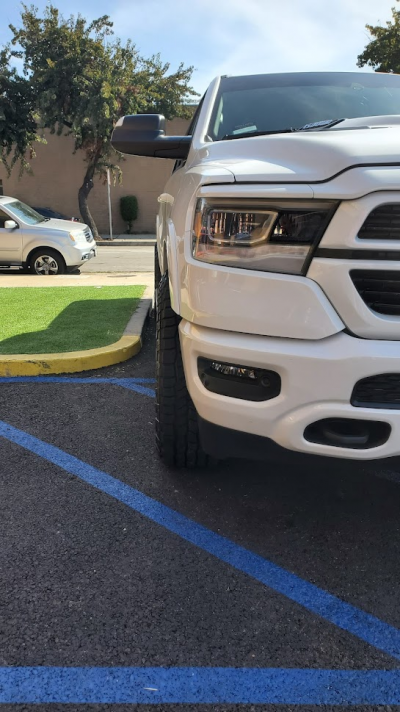

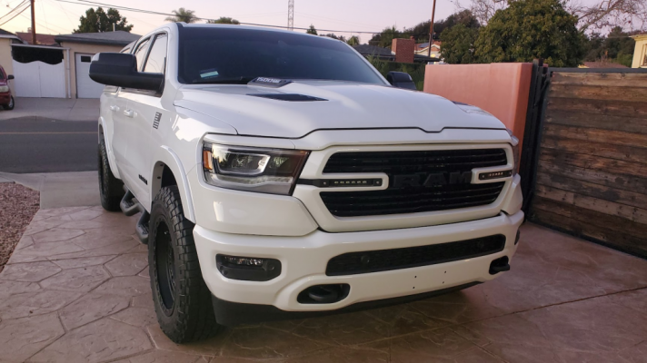

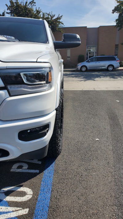

I wanted just a slight more aggressive stance and more tire wall for some overlanding. I went with +18 offset Vision Tactical wheels and 275/65 R20 Copper AT3 XLT.
They ride smooth and quiet, look just right without getting the body peppered with road debris.
