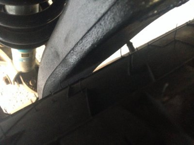

It's not a good pic but here's my 1.5" BORA adaptors. They're supposed to be the best out there. You can offroad with them, they're rated for 30,000 lbs so you're good to tow as well! They're not cheap but remember..you get what you pay for. if I could do it over I might go 1.75 just for more offset. I'm happy with the look though! My tires are 325/60/20 on factory 20's. I'll get a better pic tomorrow of the side of the truck, as well as the space on the inside of the wheel well.

I'm running a similar setup. I have the RCX 6" with 325/60 Duratracs on factory rims. I am running a 1" spacer up front. 1" is the thinnest spacer you can get and still be safe. By safe I mean (bolt-on, hub centric and wheel centric) There is plenty of room between the back of the tire and the steering knuckle. That setup gives about a 4.75" backspacing. Oh and the factory lugs stick out past the spacer, but our factory rims have deep pockets between the lug holes, so I didn't even have to cut the lugs down. You will have issues with your spare tire though, unless you get a factory 20" rim for a spare like i did.

Here's the offset

Here's mine with the 1" spacers. There is plenty of room to slip my fingers between the steering knuckle and the tire.
