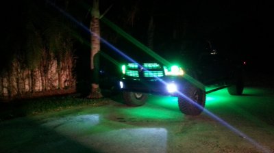

bryanlduran
Jul 24, 2013
65
27
Miami, Florida
I recently purchased a set of the spyder projector headlights with led and halo lights.
With the auto headlights where should I hook up the halos and led lights too? I tried connecting them to a few fuses like a remote wire for an amplifer but they wouldn't turn off.
Any help?
i installed halos inside on my stock 2013 ram headlights. i attached a picture so you can see. I have the halos hooked up to a switch inside the car so i can turn them on when i want. Just needs to be connected to a switch with a constant 12v power and you can turn them on yourself. if you want them to turn on with your headlights you can just tap into the wires that go to your bulb and then the halos will turn on together with your HIDs whenever they turn on automatically.
I must say, the halos aren't really too noticeable on my style headlight (i have the sport model) since its a ring around the HID the HID overpowers the oracle halo completely. It does look really bad ass when the HIDs are off though!!
Good luck!
