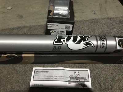

neither
Those are the cheaper adventure series, you should get the performance series Fox shocks, that’s what BDS uses
3” rear coils use 98224758
5” rear coils use 98224759
Top pic is from my shocks, bottom pic is from @Quick_Shifter
