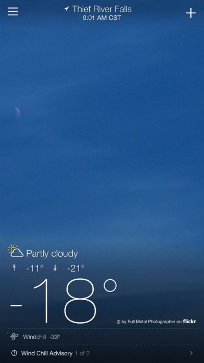

That sounds more like an intake or vacuum “whine” to me but not sure why it is doing it. Just sounds air rated to me. Mine has a whiner pulley and I don’t even know which one. I’ll do a cold start tomorrow and record it and see if I can hear any similarity. It is -19F here so might sound a little worse :(

Here as I promised is my noisy Ram.
Damn that's cold! Makes me want to go outside wearing a t-shirt as it's 11*F in Denver now.
