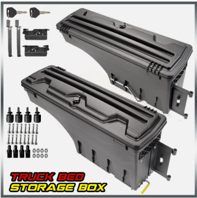

All I am seeing are various version of these boxes for 1500s and some 2500 and 3500 up to year models 2021.
I am not finding any, of many advertised (probably all from the same Chines company under different names/distributers) .. anyway, none are advertised for fitting 2022 or later 2500 or 3500 beds.
? = are they all the same?
Any help for ones that fit my RAM 2022 Power Wagon.

I got a set of these and I love them. They are in the right place to reach the tools when needed. Although I'm tall enough to reach anything a traditional style bed box that fits under the rear window, these make life much easier.
Pros: These can be very easily removed if needed. The tools are right there when they are swung out. Great for loading down with ice and hoppy, ****** canned beverages. Everything stays dry.
Cons: The plastic from almost all of the vendors is pretty flimsy. A good manly tug from a dude wearing gloves will open them. They stick out a bit too much and should fit up under the lip of the bed. They are orientated backwards from how they should be if you want them more secure. The included hardware is crap. They make a lot of noise when driving on uneven surfaces.
Due to the cons, I fully intend to adjust mine where the top can't be opened so the hinge is towards the middle of the bed so the bed lip prevents them from being opened if not unlocked and swung out. I'll also be redesigning the mounting bracket and mount position of the box and hinge so they are snug up under the bed lid and at least even with the wheel well if not recessed a little more than the wheel well. For my installation, I immediately ditched the included hardware because if someone wanted to steel the kits, all they would need is a crescent wrench or pair of pliers. Instead of standard self tappers, I used well nuts and bolts with security fittings (torx plus) so potential thieves would need to have a good tool kit with a variety of tools if they want mine. I've also come up with a way to reduce the noise. There are a lot of metal on metal contact areas, specifically the rod that hold the boxes in place. As soon as I get a chance, I'll be putting some shrink tubing over the rod to dampen the noise and hopefully it will be tough enough to last. I also plan to line the inside of the boxes with foam sheeting so the tools aren't clanging around so much. If I get the time, I am looking at redesigning the locks so they have an arm that goes out both directions lengthwise and fit holes that I intend to drill to lock the lid better. The flexible plastic and swing arm cabinet lock are a low hanging fruit for thieves. Ultimately, a tonneau cover would fit nicely and eliminate mos of the cons and areas of concern.

In my search for a set tat would fit my 2012, I found that they are universal. You'll want to get better hardware anyway. Definitely get something that would cause potential thieves to go back to their tool kit and start digging. I used torx plus security bolts because not everyone carries those in their tools, and I used well nuts to dampen the clanging and banging from the kits bouncing in the bed. Mine are about maxed out with weight. I have to assist them by lifting up on them when locking in place.

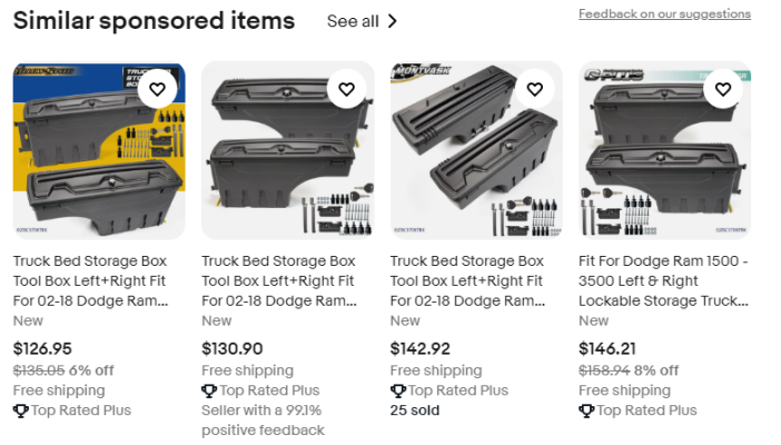

I'm just looking for a "sanity check."
PRICE POINT versus quality or (is it all the same produced in China and marketed differently?)
Everything I'm finding looks almost EXACTLY the same.
Above: I can get both sides, Driver's and Passenger's, for around $130. This was about the cheapest I found on Amazon/Ebay.
Below: This UnderCover (Set for both sides) will cost me around $440...... at $219 a side, for plastic. For that price, I'd like cheap stamped metal, at least. They look exactly the same as the cheapest versions for sale. The reviews read about the same.
I'll keep reading the online reviews, but I really don't see an added $300 in value in the UnderCover route. As per @ConorToot Post (above on this thread), I can happily pitter around with my tools and fabricate $300 worth of fun making a cheap set work.
