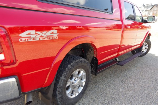

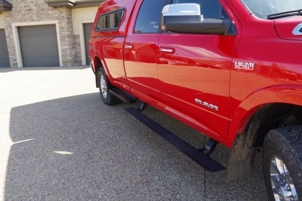

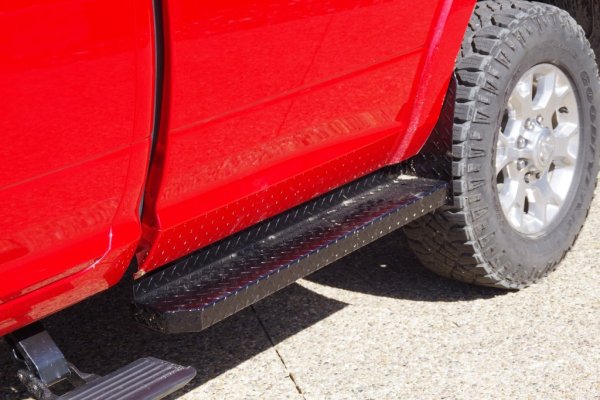

I have Weathertec on my 2021 2500. Fit good, fair coverage, but I do a lot of driving on gravel so added bed steps to keep down the rocks and will add Bushwacker sill guards. I tried 3M on the rocker panels and down the sides but it is not nearly tough enough to stand up to a lot of gravel hits.
Rear Guard, no drilling, uses existing holes. I added silicone to the screws before running them back in.

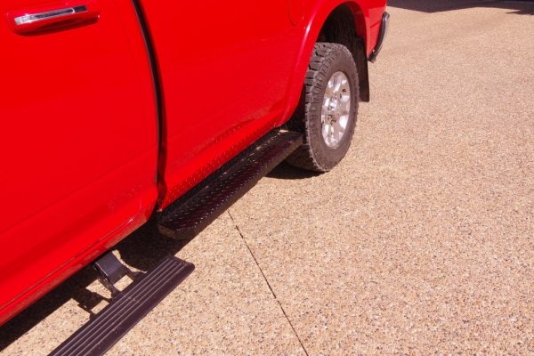

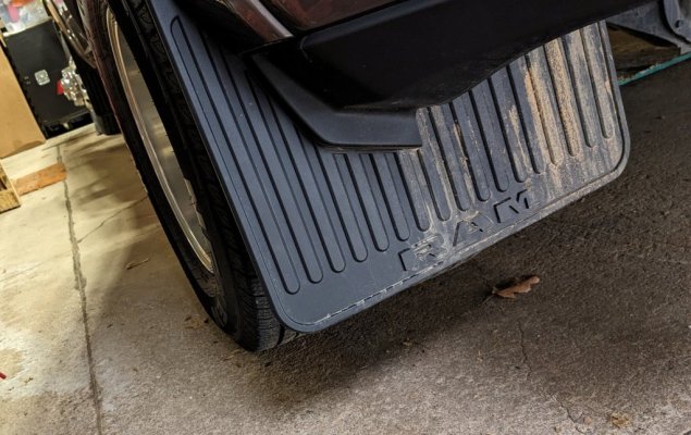

I have the Mopar Rubber mats.. They do the job!
No drilling needed and uses existing holes
FYI if you have OEM running boards hard mats may not fit !

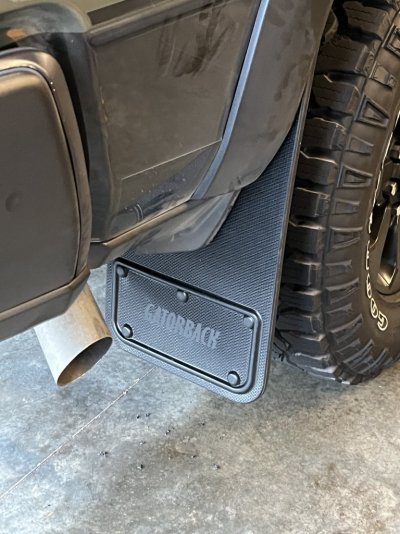

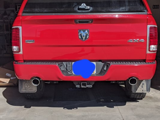

I just installed the Gatorback mud flaps on my new Power Wagon. Easy to install, but I did have to remove each tire to do so. Had to make a few 1/4” drill holes in the plastic wheel liner, but it was a very simple job. They will definitely keep the rocks from hitting our boat and wave runners in tow. I did paint the hardware black. Washers etc. The mud flaps cost $200.00. They have some that have Ram on them, but not worth the extra cost. The hardest part of this job, is lining the rims up with the lugs. Once that was done, I torqued the lug nuts to the proper spec. They are flexible and heavy duty. https://www.sharptruck.com/

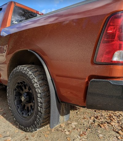

I had factory and also had some aftermarket ones but did not do the job I wanted them to do (control overspray and prevent throwing undesirable things at the truck side body on gravel roads). I opted for ones that wrap up almost vertical in the wheel well and extend from the body to reduce the overspray as well as being wider than my tires themselves. Used existing holes.

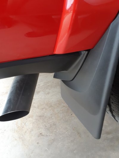

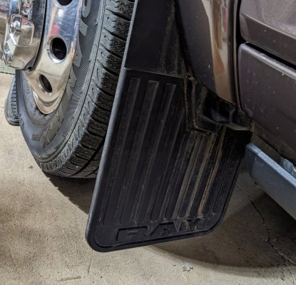

I installed the MOPAR flaps on my 2024 Dually. They definitely help. Without them there was significant mud deposited in the back bumper. I just pulled my enclosed trailer on a gravel road and it still received quite a bit of spray, even with the flaps installed.
There are a few 1/4" holes to be drilled in the plastic liners to install.
